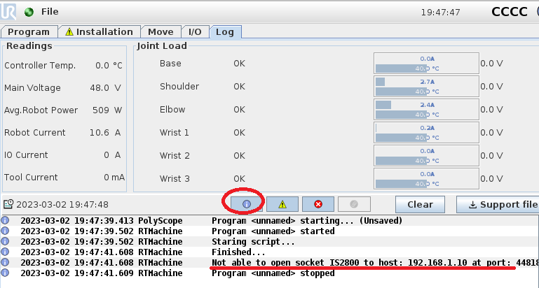

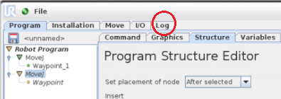

Thank you for adding the additional info! What triggers me is that you say it works when using your pc.
Can you run your program and then make a screenshot of the log tab?
My suspicion is that the log will probably look like this (make sure the info icon is toggled on):
Can you either confirm you get this in your log or send the screenshot of the teach pendant if it is different?
