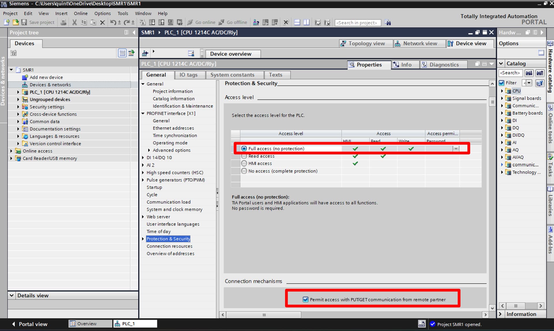

Ensure that your PLC is set up correctly. In the general properties of your device, navigate to Protection & Security. Change the Access Level to Full Access and enable the PUT Get Communications.

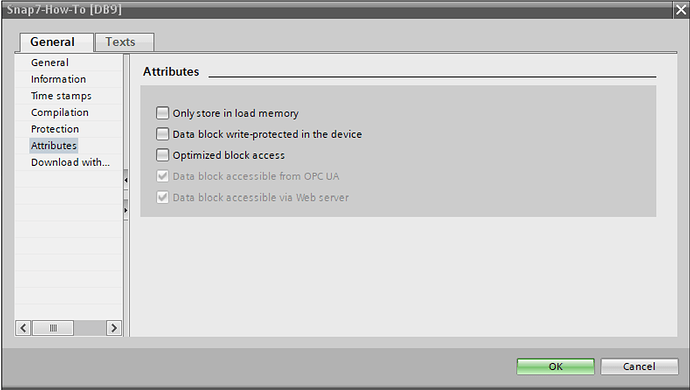

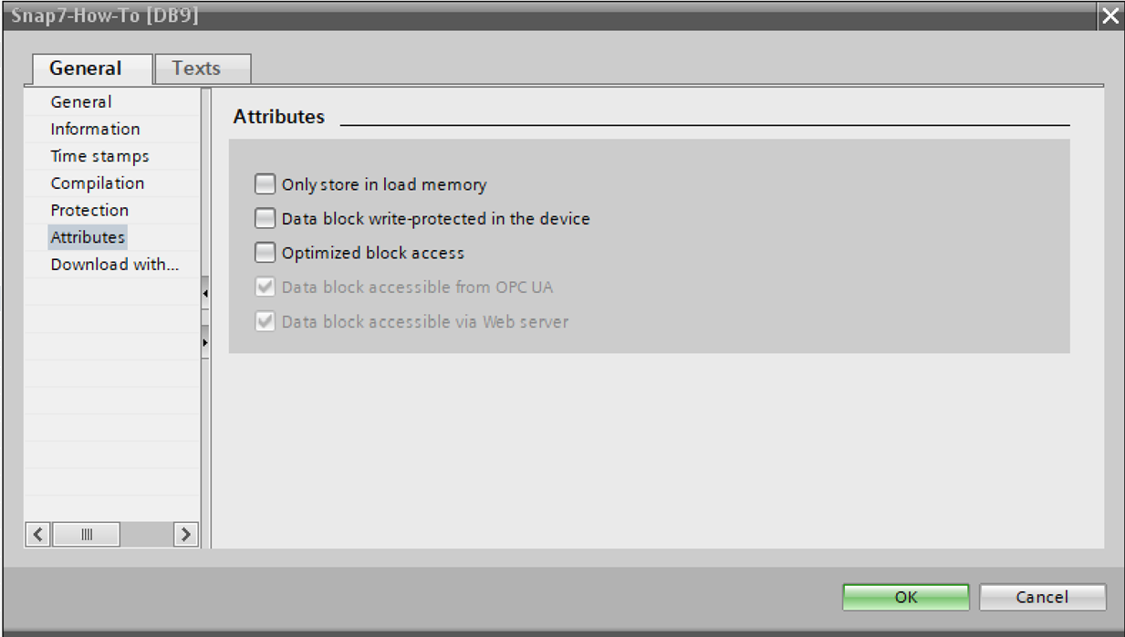

Next, go to the data block (DB) you wish to control, right-click, and select Properties. Under Attributes, ensure that Optimized Block Access is turned off.

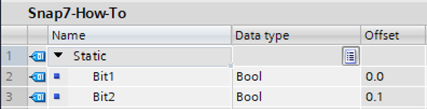

If everything has been configured correctly, compile your project. You should see an offset next to the variables of the DB. Finally, download your project to the PLC, and your PLC will be ready to use.
