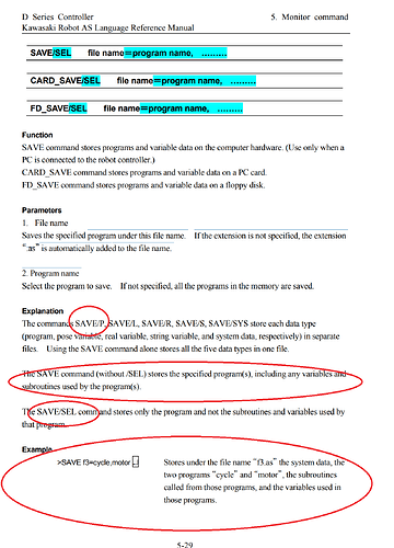

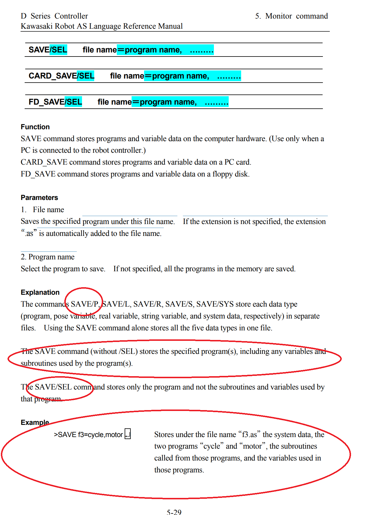

We were unable to download a single program from the Kawasaki as well. Any attempt to download a single program results in download every program on the machine as well as their variables, etc.
To summarize: Does anyone know how to upload/download a program successfully?
The extension doesn’t seem to be the problem and we’ve tried uploading programs with and without an empty line as the last line.
We also used the Ruby Script of Thijs which can be found on Drive (Kawasaki writer) but this also didn’t fix our issue. We have tried uploading the same script to the robot of another group. The script uploaded fine on their robot whereas it kept giving errors on ours.
Uploading a script using unique variable names is a temporary solution for us, but won’t work well on the long-term. We talked with Thijs about it and he suggested it might be some global flag that prohibits the use of global variable by multiple programs.
