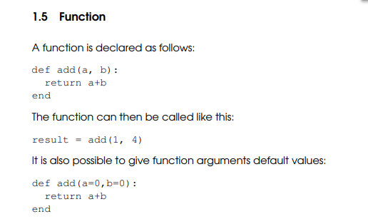

What is your goal? You want to call some block af code, like a function?
Will this help? Or do you need something else?
