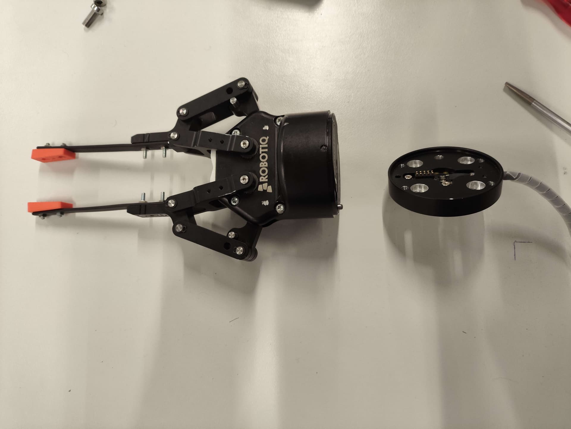

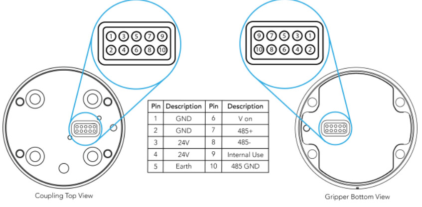

Step 1: The first step to installing the robot-IQ gripper is to connect the mounting piece to the end-effector of the robot arm. Now screw the robot-IQ gripper into the mounting piece, make sure the pins on the bottom of the gripper align with those on the top of the mounting piece.

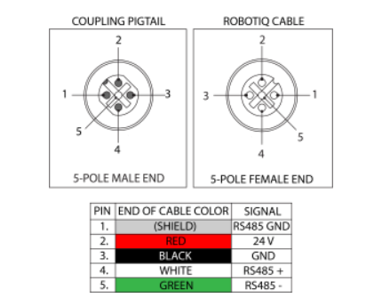

Step 2: The second step is to differentiate the wires that come from the robot gripper. Look at the indent in the 5-pin wire and start connecting from there, using the following picture:
(If the extention wire you use does not have the same colours as the image above, you can measure the wire through. In this case you want to disconnect the robot gripper from the mounting piece and measure the cable through. You will know what wire serves what purpose by looking at the picture we used at step one and seeing what tag is connected to it. P.S.: Don’t worry if the VCC cable cant be measured, this wire cant be read for safety reasons)

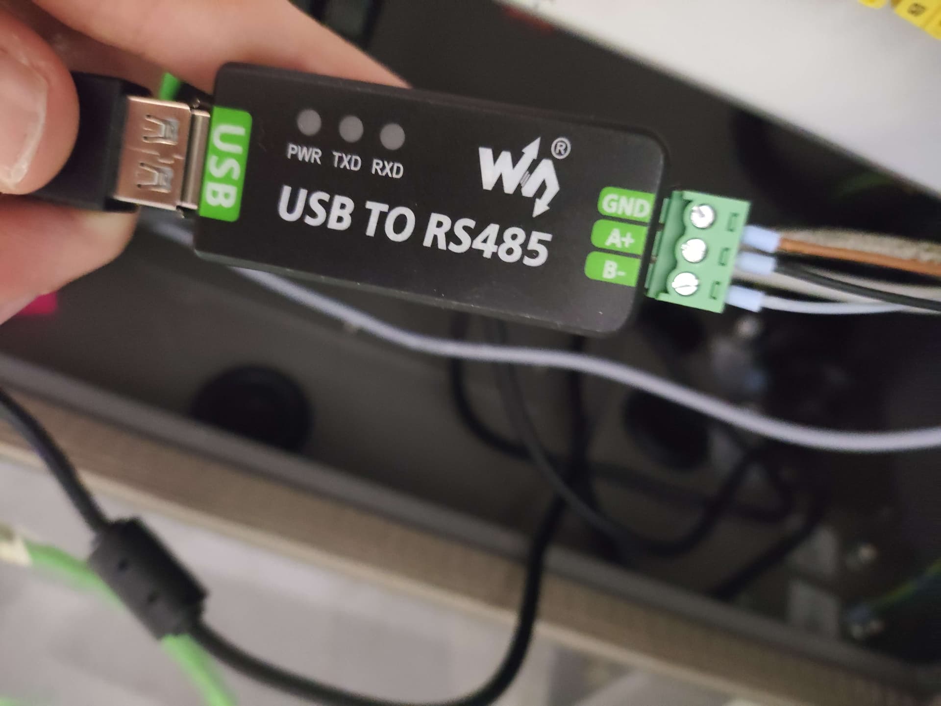

Step 3: Connect the RS485+, RS485- and RS485 GND to the corrosponding pins in the RS485 to USB converter. Connect the 24 V and GND the corrosponding places in the PLC.

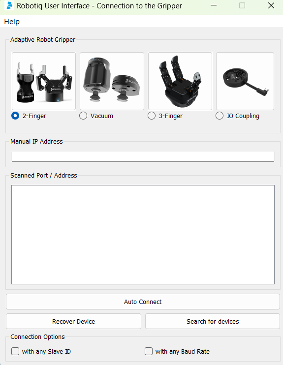

Optional Step 4: To test if the gripper actually works you can try and control it using your laptop. In this case you want to connect the RS485 to USB into your laptop and make sure the 24V is active. Now install the user interface on the site of robot-IQ (The software: * Installer (v2.4.9)) (The site: Support | Robotiq)
Set the software up, if done correctly it should look like the following picture:
If you have the RS485-USB converter plugged into your computer and search for devices, a port should pop up and turn green. At that point you click on Auto connect and you can control the gripper using the interface on your computer. If a port pops up but turns red, either your pins are not making contact with their port or you have not turned the 24V on yet.
