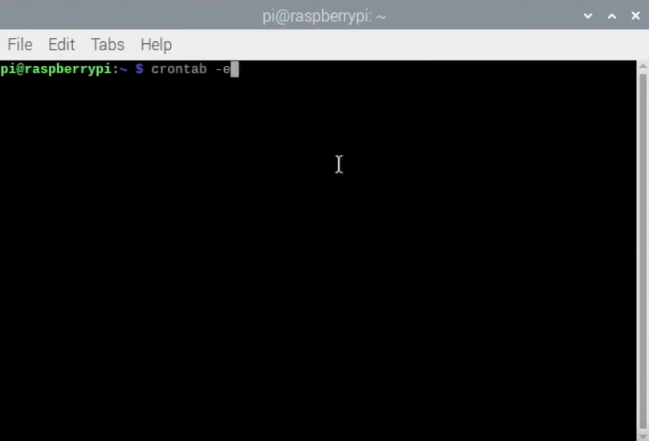

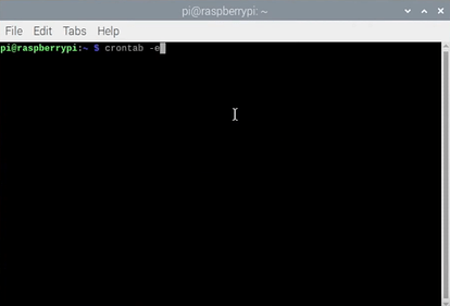

Step 1
Open your terminal and write “crontab -e”, when opened for the first time an editor needs to be selected. For this example we choose nano.

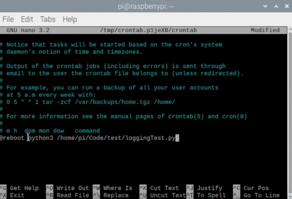

Step 2
After opening nano navigate down to the bottom of the document. Here you will need to write "@reboot python3 " followed by the directory your file is located. If your following this tutorial using nano, you can press ctrl+x to exit the editor, then press ‘y’ to save the edit.
