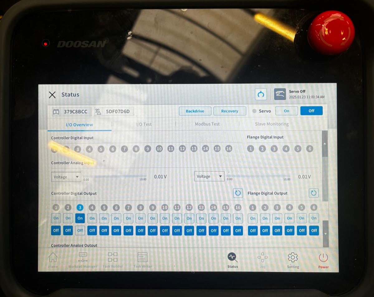

1. First we will need to unpack the robot. For that, we will need to go to the “Status” screen and press son the recovery button.

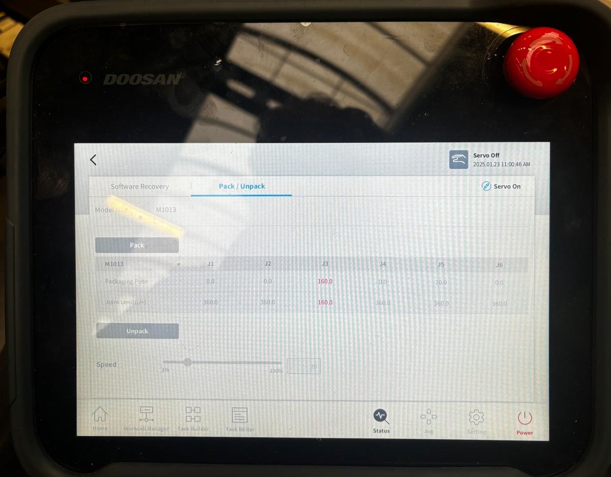

2. Then you need to press on the unpack button and keep it pressed until the robots stops moving. Now the robot is completely unpacked.
