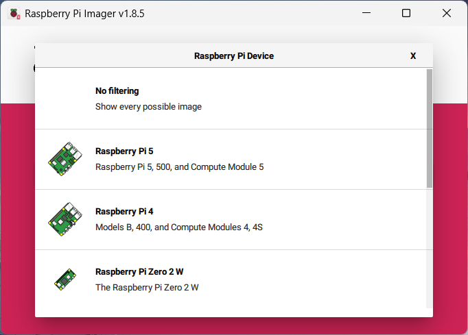

Select your raspberry pi board

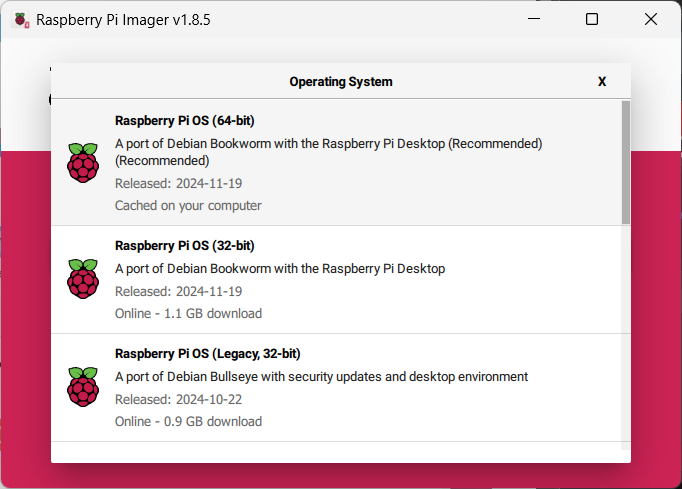

Select your os and storage

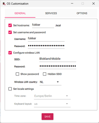

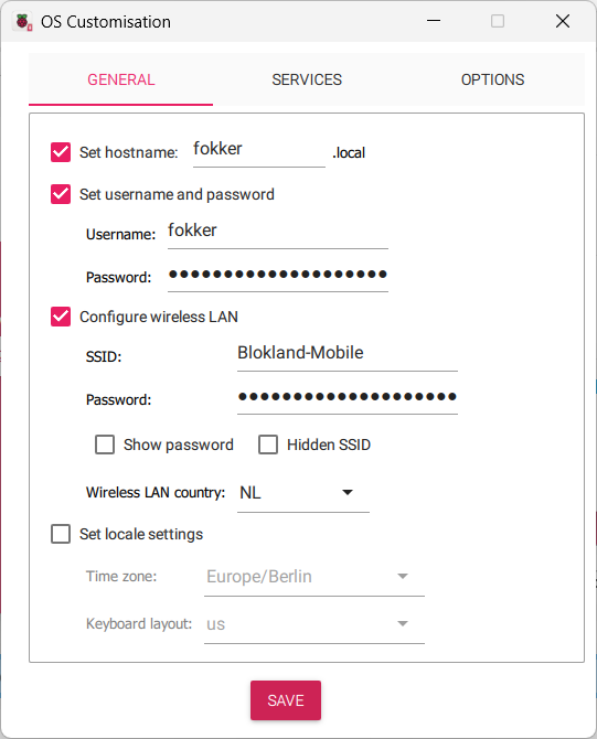

Setting up os customization
Press ctrl+shift+x to open os customization window, fill out the host name, username and password for your rpi and enter your wlan ssid and password. next go to services and enable SSH.

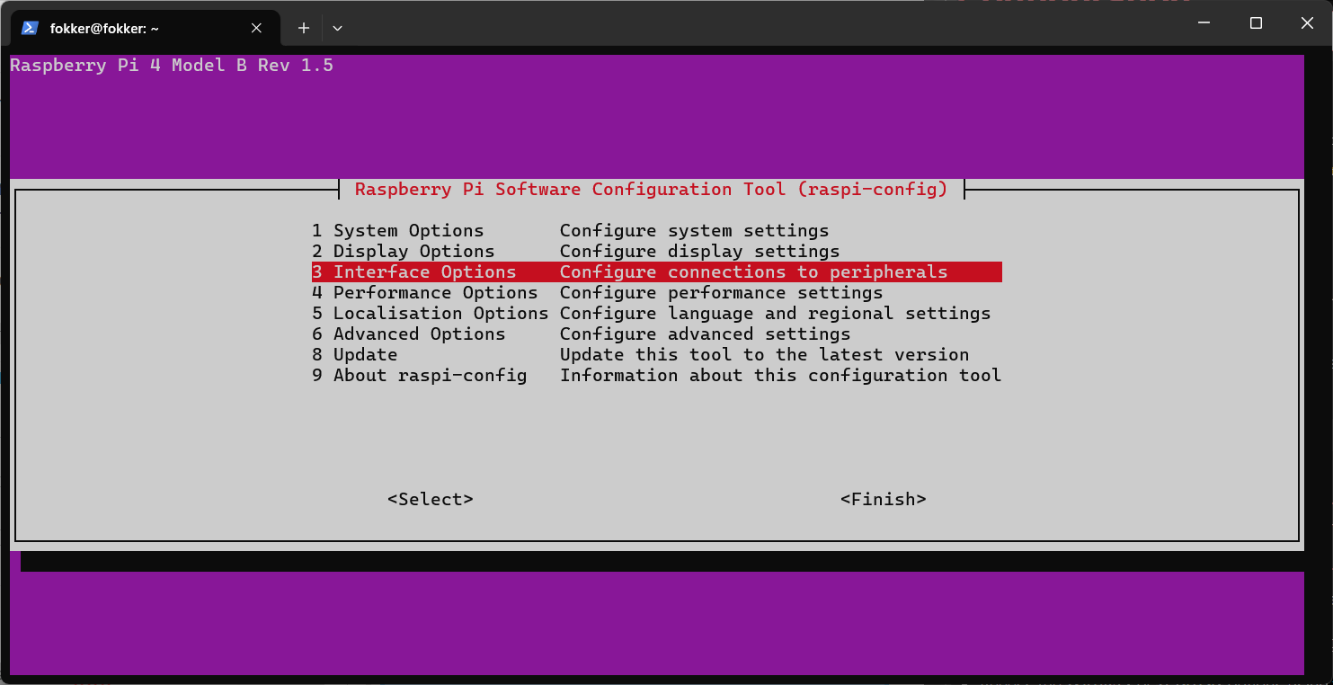

~$sudo raspi config, select interface option, vnc, activate.

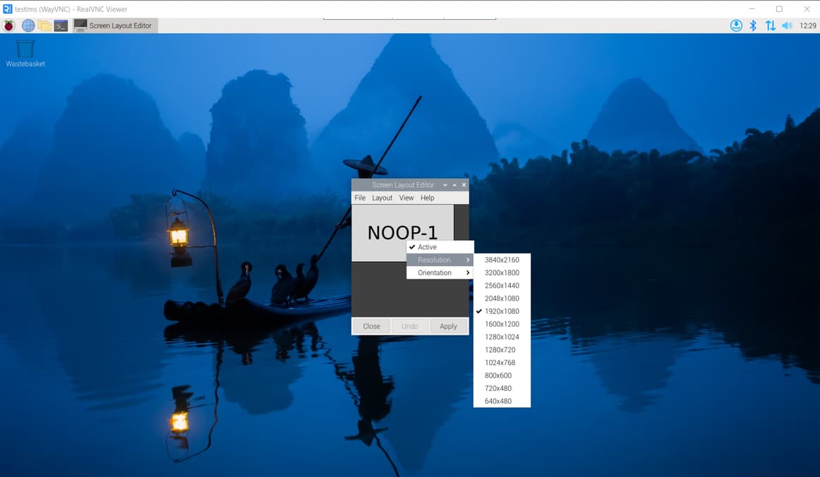

Now you can install RealVNC viewer Download VNC Viewer by RealVNC® and connect remotely by entering your hostname@username
