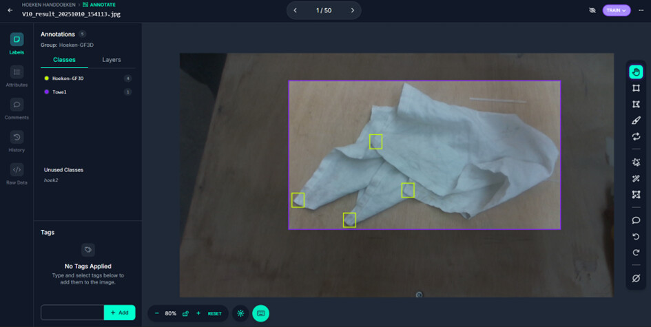

After deciding the project type its time to start annotating images. Upload the images and start making the boxes or keypoints.
When making the bounding boxes make sure not to make them too big or too small you should have your object perfect in frame. For example the towel and corners of a towel.

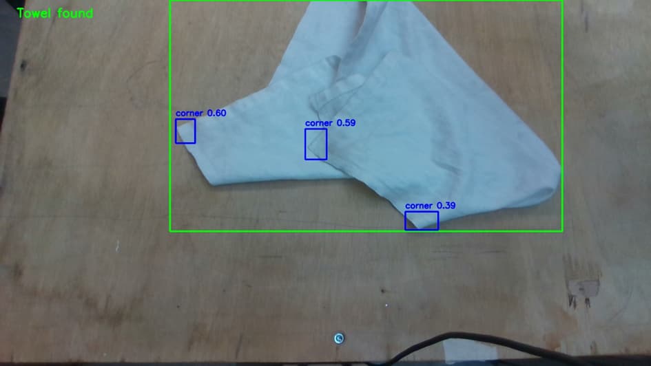

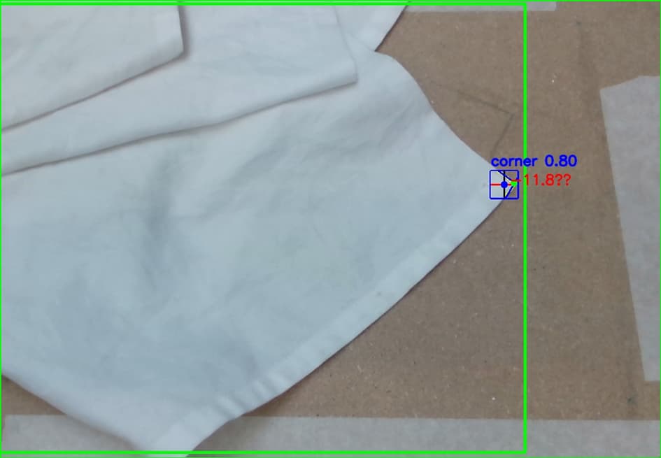

Transferring the AI detection to coordinates
After training and running the AI you can start to get the coordinates needed. You can easily get the middle point of the bounding boxes with these coordinates:
results = model(frame)
    boxes = results[0].boxes
    if len(boxes) > 0:
        confs = boxes.conf.cpu().numpy()
        max_idx = confs.argmax()
        best_box = boxes.xyxy[max_idx].cpu().numpy()
        x1, y1, x2, y2 = best_box
        cx, cy = (x1 + x2) / 2, (y1 + y2) / 2
        print(f"Most confident center: ({cx:.2f}, {cy:.2f})")
        # Draw box and center
        cv2.rectangle(frame, (int(x1), int(y1)), (int(x2), int(y2)), (0,255,0), 2)
        cv2.circle(frame, (int(cx), int(cy)), 5, (0,0,255), -1)
If the bounding box is not enough you can use OpenCV code to check for the perfect point in the bounding box. Using an AI in combination with OpenCV code will help you make a perfect version to get the perfect pickup point
