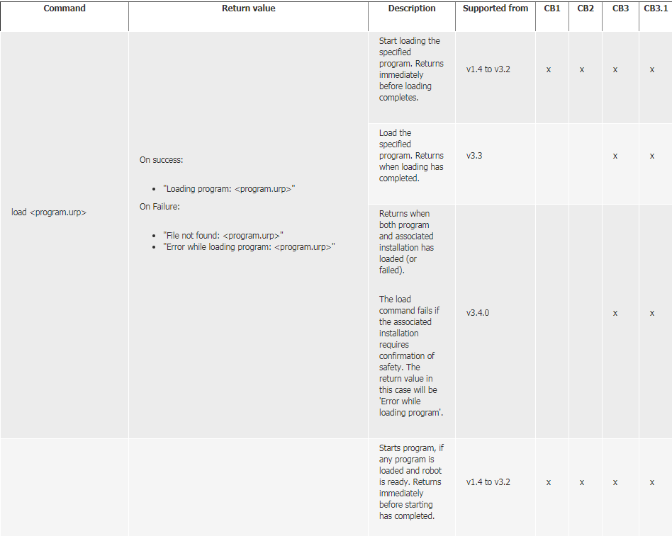

It depends on what you want to do, as you can see in the table (from the link) you can write only the inputs and outputs. Not the states of the machine. This was also the problem with the profinet connection.
Ethernet gives you this opportunity to change the states by sending strings like “play” en “stop” to a specific port of the robot. (see link)
https://www.universal-robots.com/how-tos-and-faqs/how-to/ur-how-tos/dashboard-server-port-29999-15690/
this is what we did in our project and thereby the use of the teachpanel wasn’t necessary

So basically we would need a chart with all the functionalities and which ones work over Ethernet, Profinet and Modbus?

in the topics you can find that kind of charts you want
see below for “load” command and on the right of the image the functionality/compatibility for each type of robot and firmware version
