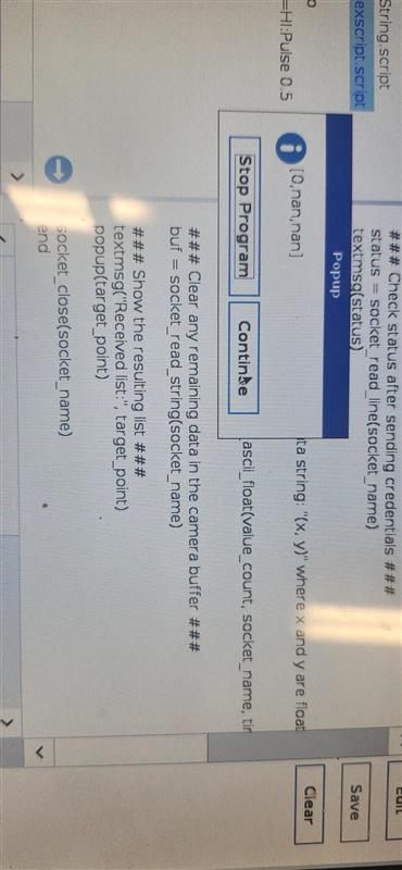

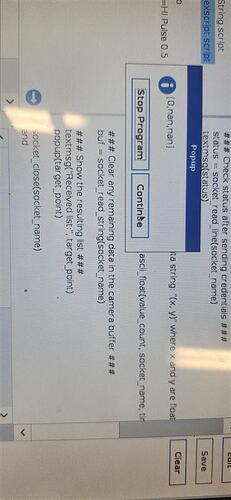

i had an issue of sending string from my cognex d905c camera using in-sight vidi suite software to my UR robot over TCP/IP using tcpclient function on vidi suite
the connection is established but i’m still getitng (0,nan,nan) in my robot !
does any one know how to fix this issue
