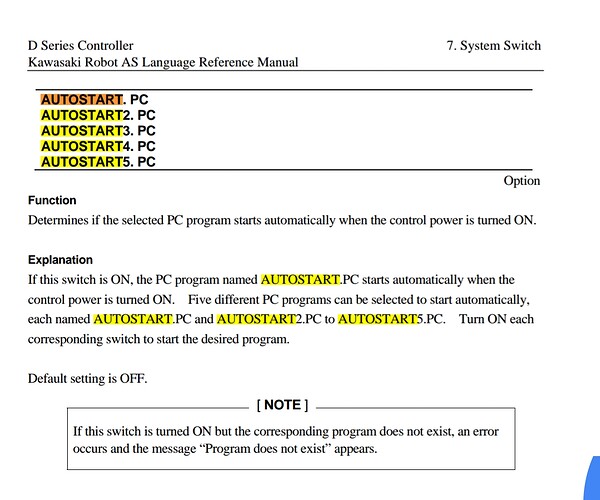

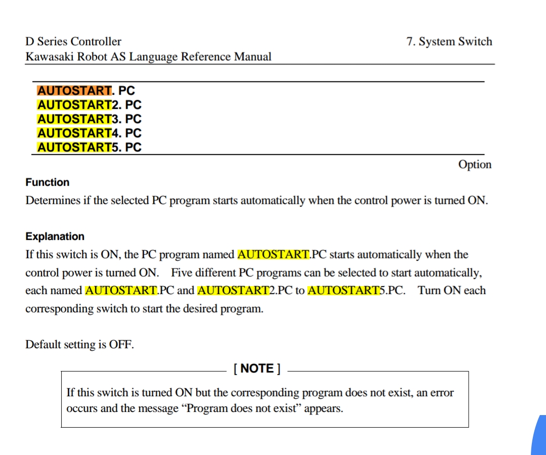

We are running a Program via autostart.pc()
the code goes as follows
.PROGRAM autostart.pc()
WAIT SWITCH(POWER)
CALL main
.END

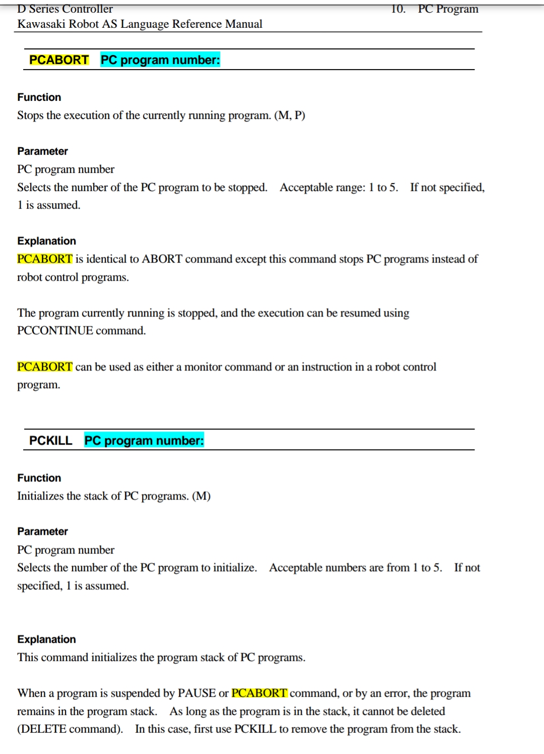

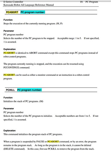

We do send a stop command in the main function but the program keeps on running. How can we stop a program that is run via autostart.pc() externally.
