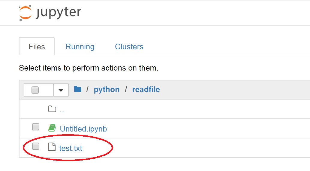

  • from what folder are you trying to run your code?
  • can you make a screenshot of the Jupyter file list like below?

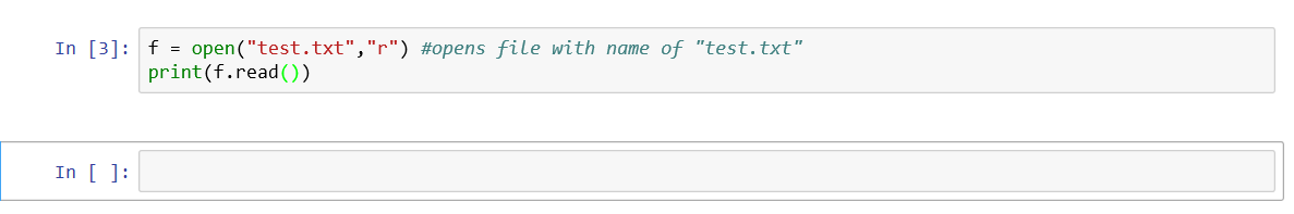

My steps to reproduce
Create file “test.txt” with some random content in the same directory as the Jupyter Notebook file
Python code in Jupyter Notebook:
f = open("test.txt","r") #opens file with name of "test.txt"
print(f.read())
Output when running the code:
If you provide the details as requested above I might be able to help you out.

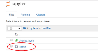

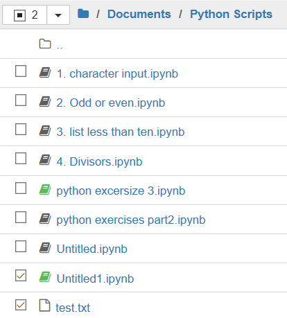

Here is the file “.txt” file located, in the same folder:
(the checked boxes are the ones i used)
Although this time i figured out why i got the error. It’s because i deleted the “.txt” at the filename by changing it.
But now as shown, i don’t get any print results.

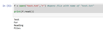

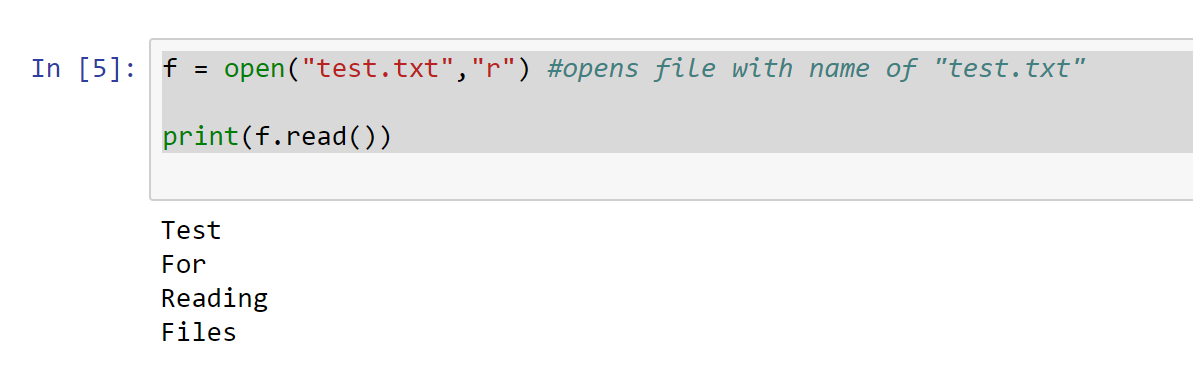

The content was like you wrote.
Probably the edited .txt file (with content) wasn’t saved before i ran the program.
So the saved (default) version i wanted to open was ofcourse empty.
I tried to run the program a couple minutes later and now the .txt was autosaved which made the program run.
My problem is solved!
