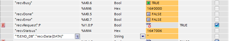

This is the watch table I use to watch the variables. The status says: 7006 which means the connection is active and ready to receive data. But when I type something in socketTest nothing changes on the watch table. I use port 4000 on TCP.

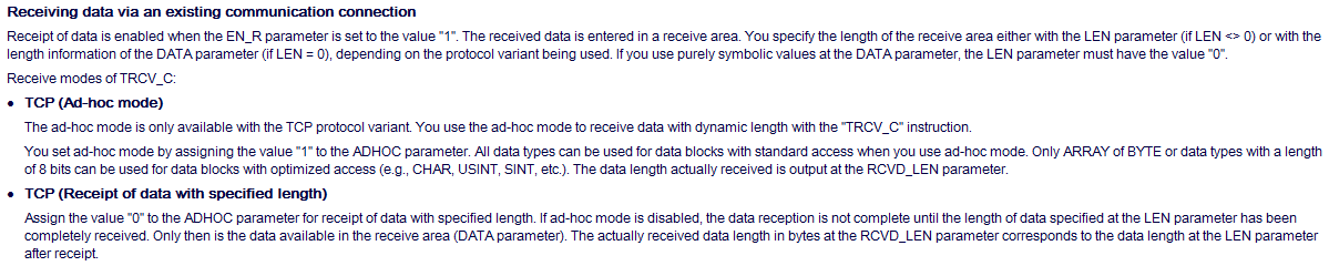

I think you can find the answer in the help file of the block in TIA Portal. Click on the block and then press F1.
I have added the relevant information below:
You can try the following:
If you want to use ad-hoc mode (ADHOC = true):
  • Change the data type of recvData(DATA) to ARRAY of BYTE (probably ARRAY of Char will also work, but I’m not sure).
  • Or disable optimized block access of the TSEND_DB block. You can find this setting by right clicking on the block in the project tree → Properties → Attributes → Uncheck “Optimized block access”.
When disabling ad-hoc mode (ADHOC = false):
  • Make sure the LEN parameter is set. Only when LEN is equal to RCVD_LEN the data will be available.
