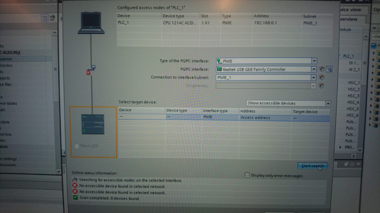

my TIA portal can’t seem to connect to our PLC. I have set the ipv-4 ip to 192.168.0.15 and configured the TIA project with PN/IE-1 but it is unable to find any compatible or accessible devices. Wondering what could cause this.

it works with exactly the same settings on Menno’s laptop, so i think it’s a problem with my laptop. Could it have something to do with me using a USB-C to ethernet adapter?
Yes, that can be the reason. In the pas I’ve seen some problems with USB to ethernet adapters and compatibility with TIA Portal.
There is a workaround available. If you double click on “Access address” you can manually fill in an IP address. After this press enter. TIA Portal will try to connect directly to the device without searching the network first. After this you can proceed as normal by clicking the load button.

Yes. Should have mentioned it here. Lloyds solution works.
