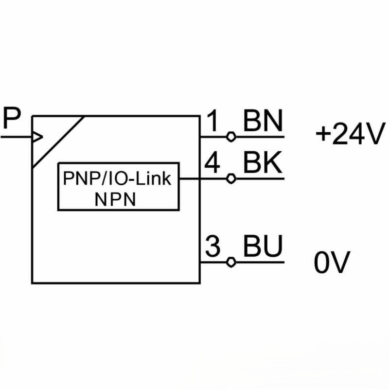

Step 1: Wiring the sensor

By connecting the black wire to an analog input of the PLC, the analog value of the sensor can be read into the I/O of an universal robot.
