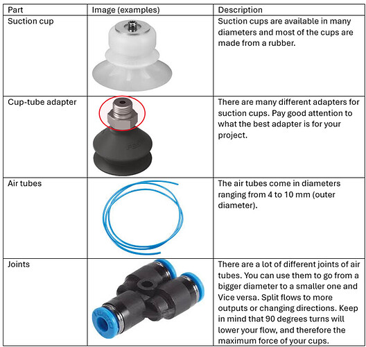

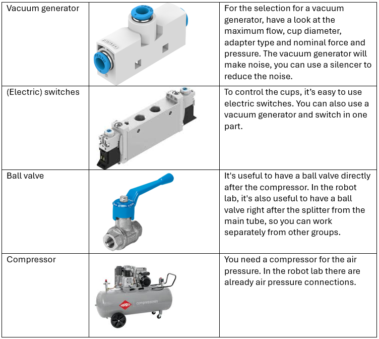

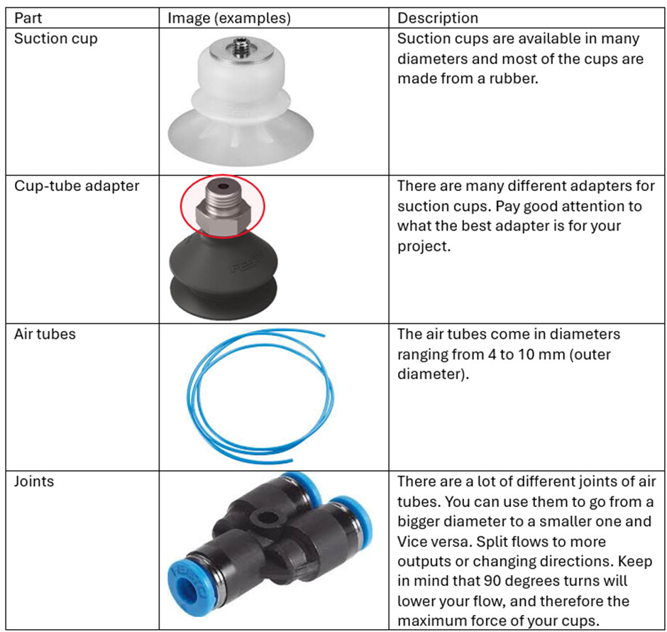

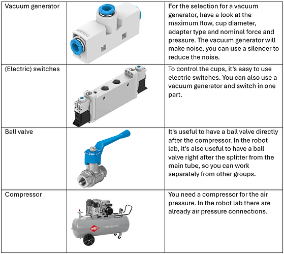

What do you need for suction cups?
Note: there are a lot of different components and variations for a system with suction cups, this table is only a basic overview of the separated components you will need. Festo has a complete assortment with all components. Have a look to the delivery time, other companies are mostly way faster.
